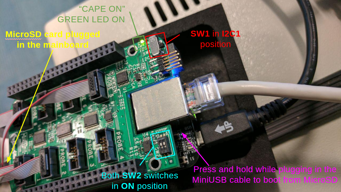

First step is to get an IIO version of the ACME BeagleBone black image. The recommended way of using ACME is to use the pre-built image provided by BayLibre.
If you are using a MicroSD card, please ensure that the card is properly inserted in its slot and to keep pressed the power push-button while connecting the power (via the miniUSB cable). Here is an image of the configuration we usually use:
_images/ACMECapeBoardConfiguration.png
