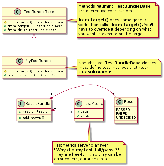

The relationship between the test classes has been condensed into this diagram, although you’ll find more details in the API documentation of these classes.
class TestMetric {
      + data
      + units
note bottom of TestMetric {
     TestMetrics serve to answer
     <b>"Why did my test fail/pass ?"</b>.
     They are free-form, so they can be
     error counts, durations, stats...
class Result {
      PASSED
      FAILED
      UNDECIDED
class ResultBundle {
      + result : Result
      + add_metric()
ResultBundle "1" *- "1" Result
' This forces a longer arrow ------------v
ResultBundle "1" *- "1..*" TestMetric : "          "
class TestBundleBase {
    # _from_target() : TestBundleBase
    + from_target() : TestBundleBase
    + from_dir() : TestBundleBase
note right of TestBundleBase {
    Methods returning <b>TestBundleBase</b>
    are alternative constructors
    <b>from_target()</b> does some generic
    work, then calls <b>_from_target()</b>. You'll
    have to override it depending on what
    you want to execute on the target.
class MyTestBundle {
      + test_foo_is_bar() : ResultBundle
note right of MyTestBundle {
    Non-abstract <b>TestBundleBase</b> classes
    must define test methods that return
    a <b>ResultBundle</b>
TestBundleBase <|-- MyTestBundle
MyTestBundle .. ResultBundle
